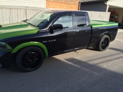

This is on a 4wd so the front doesn't come down as much with the strut so the front is a 4.5" drop and the rear is 6.5". I've got about 1.5" of clearance between the tire and inner fender.

Its too raked for me,
I was thinking of I modify the rear bump stops, I could lower it more and still have some suspension travel

You need to cut out the bumpstop cup completely if you want suspension travel. The next place it will hit after the bumpstop cups are gone is the lower control arm on the upper arm's frame mount but you will have about 4" of compression before that happens at a 4/6 drop and then you should seriously be thinking about redoing your axle mounts to realign the rear control arms.
