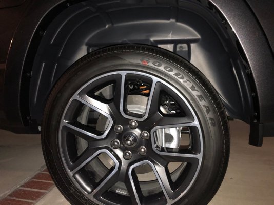

If anyone is interested....installing the rear liners. Super simple and much cleaner.

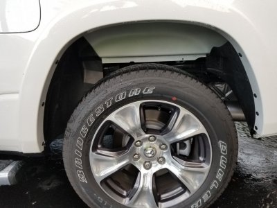

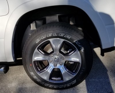

Before and after. 45 minutes. If anyone does it, you only need 2 extra screws when you buy the liners.

Is this the “simple” installation?
I didn’t like the fishing out the clip part and drilling.

Just installed mine tonight, it’s really not that difficult. The rear 1/4 piece that needs to be drilled is necessary because the carrier plate has to be used with the nutplates. They are really easy to separate and honestly, I’d rather do it than have some dealer tech hog it out....super simple.
Looks waaaaay better!!!

The 3 clips up top to pull out were easy. I used a paint can opener and lightly pulled up and out. Came right off without any damage.
