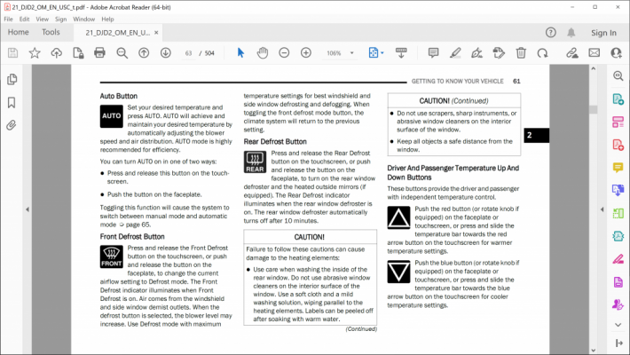

The button for the heated mirrors also activates the rear window.
I have the 8.4 in my tradesman that does not have heated rear window but it has a rear window defrost option on the radio? Maybe that that if you have the 8.4?
The physical button on the center stack is the same as the virtual button on the radio. Either location will toggle the mirrors and back window defroster on/off.

Crash is correct, but also, neither will turn on during remote start if the temperature is not cold enough. Also, both mirror and rear window heat turn off after a certain period of time.
