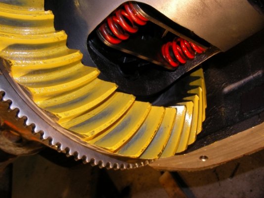

Edit: I'm adding my ring gear coast and drive grease patterns. When I did the job, I was very interested in seeing such examples for a comparative reference. How good is good 'nuf? These aren't perfect, but my diff is quiet and has performed for me for 50,000 miles now.

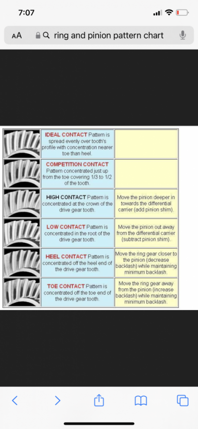

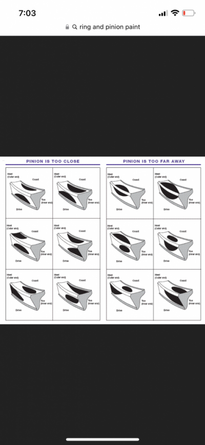

calinb- I have to assume you reinstalled your used gears. Looking at the coast side the pinion appears to be too deep, not much. If the gears are quiet than keep going.
Attached is an example of the difference between new and used gear patterns.
Notice in the second pic the sharp edge you get from too deep or too shallow pinion.
Your looking for smooth ovals. It’s easier with new gears. Around 4:10’s you’ll start to notice the oval changing as you get bigger 4:56, 5:88, 6:17.
Only trying to help so don’t shoot the messenger.
You don’t need all of the specialty tools but you will need a decent dial indicator with base. You’ll probably never use it again.

Thanks for your reply, CaptQ. Yes--I used the old gears. With all the snow plowing I've been doing this year, I'm thinking that I should have changed them out along with my old differential carrier. I'm geared too tall for optimum plowing use and the tall factory gearing is tougher on the clutch when plowing too. I didn't plow snow where I lived when I did the overhaul.
It was several years ago but I think my phone conversation with Yukon tech support was along the same lines you mentioned. I finally settled for the best overall pattern that I thought was going to achieve and it's been quiet for ~50,000 miles now. Hopefully it will stay that way for a good deal longer but, again, I'm plowing a lot. Yeah--I should be using a 4WD Ram 2500 (a flatbed would be ideal) but this is my older pickup and I don't want to risk bending metal on my much nicer Cummins Big Horn Ram. Plowing can be dicey sometimes at my place in N. Central Idaho!
