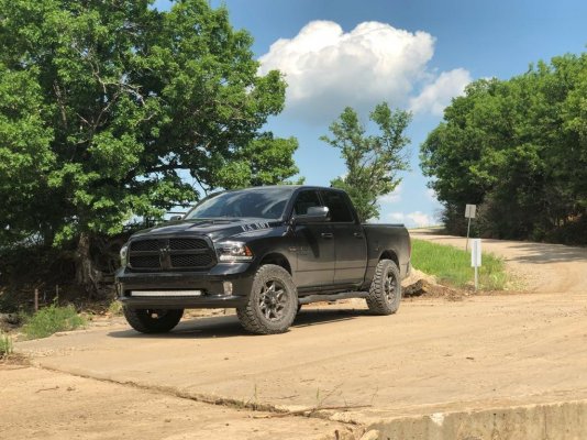

I did the super lift with the bils. I like it rides nice with the bils. I took the preload spacer out and set bils at 2.5. I have 24x14s and 35s. I get a tiny rub at 1 full turn anything past that or before that nothing I barely touch the lip on the bumper hasn't even work paint if in 15k miles.ac9a49f63bbc945e686d6a684a0b5ebe.jpg

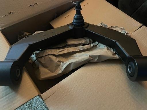

Just got my Zone UCAs today thru Nick. Bringing them to lift shop to get them powder coated to match truck.
