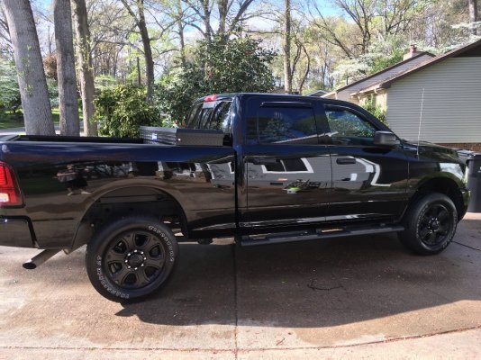

3 years old and this is what my paint looked like, i never once polished this truck, some say that waterless and rinsless washes will swirl your truck, not if you do it right

How much orange peel do you have? I used Carpro velvet pads on my white 04 Ram with M105 had minimum results.

if you are asking me, you can see in the pix how much orange peel my truck had, polishing pads wont remove orange peel, you have to sand that off and then polish the truck

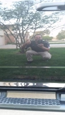

I'm giving Optimum a go on their rinseless wash for my black edition 2500. I had a **** ton of swirls when I bought and referred correction out to a local guy that offered a price I couldn't refuse despite being able to myself. Then coated it with chemical guys black light to fill in any left over imperfection, then their sealant and finally their 5050 concourse wax. It pops and has a better reflection than factory. As mentioned the less you scrub it or use auto washes the better. I'm my opinion, Chrysler used a soft paint for a paint cause just getting out of my bed, I brushed the side with basketball shorts and put fine scratches in it. But after the work this is the result

chemical guys black light is simply amazing! its a miracle on black paint, follow that up with their black wax, yes its $70 wax but its awesome!

I only did a single step correction on it cause it's still a truck and to spend the type of money for two or three step correction wasn't worth it. It's to my liking now and still leaves room for more correction down the road if need be. I personally think the paint used on these trucks sucks. I have orange peel, overspray and other imperfections for a trucks that's never been painted shouldn't have. The correction fixed a lot but not all of it.

where did you find overspray on your truck?

Door jams, filler neck area and under the hood. We even tested the paint depth to make sure there was no paint work done for factory respray or something and it's on point per factory so I just don't really get it. I used to detail and even did post body work correction and this paint is just really soft. Way too soft for a truck in my opinion. I bought it used so not like I can return it but that's why I did the paint thickness reader on it to make sure

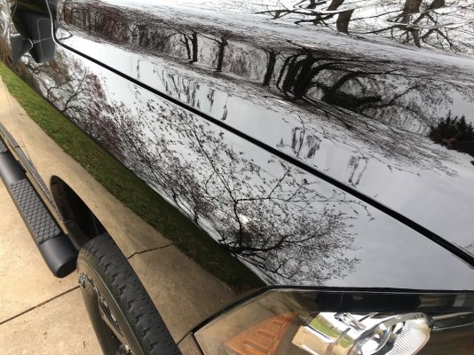

Wash, black light sealant, buttery wax, topped with detail spray.
