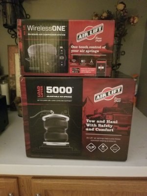

What up my Ram members,
I am adding a airlift 5000 to my ram along with some other goodies, anybody install one on there truck??

I have installed plenty of these kits on my own trucks and my customers as well. I like to be creative with my installs and hide the compressor and the lines. You can put it anywhere. Q
I have mounted the compressors from inside the front bumper on a custom bracket that connects the frame rails together, inside the storage wells in the rear floor, in the lower center console with some modifications and inside toolboxes. I really liked the one I mounted up front behind the bumper on a bracket between the frame rails. I then ran the air lines inside the frame rails to the rear bags.
