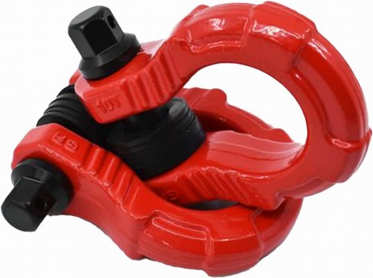

This is what I use on my 2500. It is a 2.5" shank, fits perfect and no slipping or damage to tugem straps. I use the same kind of shackle on the front, hooked onto the winch bracket.
