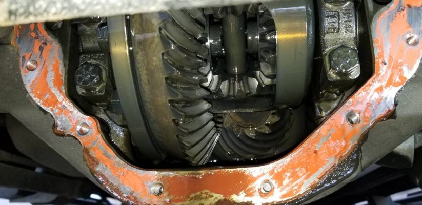

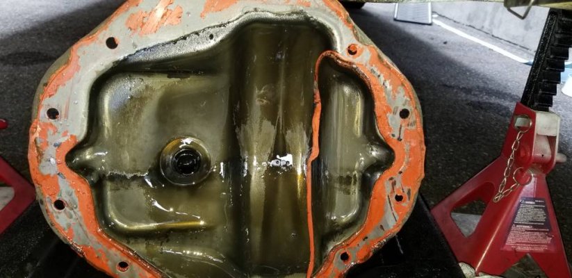

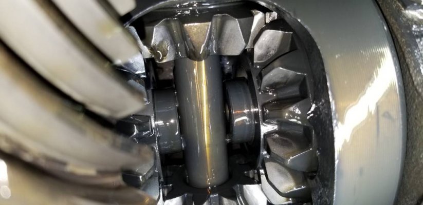

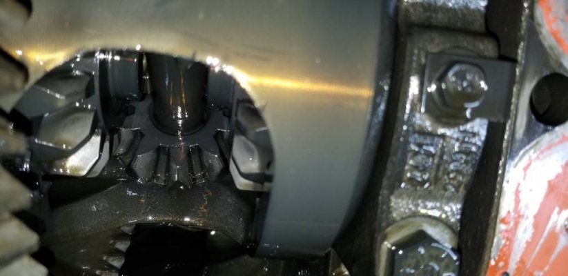

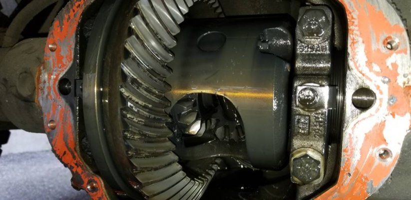

ok so the cover is off
first thing I noticed is the enormous amount of rtv that was use, is it like this from factory?
next is that it look like the redline was cleaning the housing pretty heavily as it came out very grayish and you can see spot in the cover where risidue was getting cleaned.
so far everything look normal and no metal shaving came out except for what appears to be fine metal dust in the oil.
I didn't drove the truck right after doing the fluid swap, I simply back off the driveway and park it in the street. I noticed the noise 2 days later when I was bringing my daughter to school, then I left for a 600 miles trip where i would notice the noise from 10 to 40mph and then the road noise would mask it. came back and parked it sinceaeec659807407e220abf4095b96e06c0.jpga4824e69879559ba4275eca1aa3d521b.jpg6d3af67b9f3df2efe5419dae7348160c.jpgf32be7e0f07b1a9bf7effed909e06f73.jpg2364ff0e48825cb7657acd562b5dbf9d.jpgdeb3d4bad061bbaf52b16b11b4feb5fb.jpg

With only 48k l, depending on the year of the truck, that might be covered by the drivetrain warranty??
