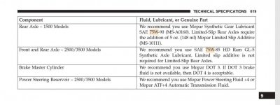

My 2018 Express manual calls for 75W-90 in the rear and 75W-85 in the front.

page 602 2018 ram 1500 take 70w140 rear axle, pdf not secure.

Interesting, my manual says 75W-90. Both the pdf and printed one?

My printed 2018 manual says 75W-90 for the rear axle as well.

I am sure they went to the thinner fliud for the sake of .00001 more miles per gallon to make the government happy.
EXACTLY. We recommend still going with 75w140 especially if you tow.
For anyone interested, 2 quarts of 75w85 or 75w90 for the front and 3 quarts of 75w140 for the rear. Message me for pricing
