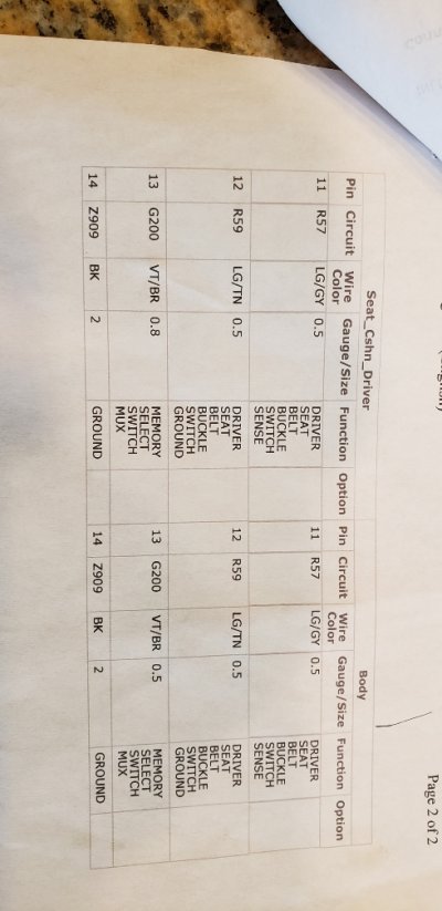

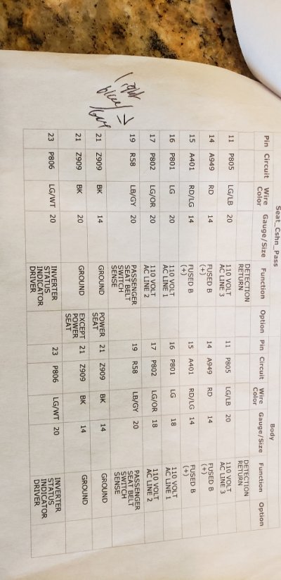

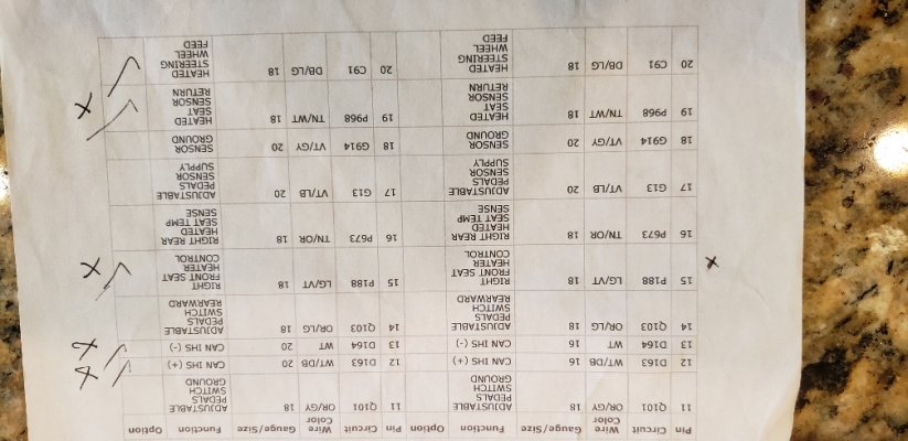

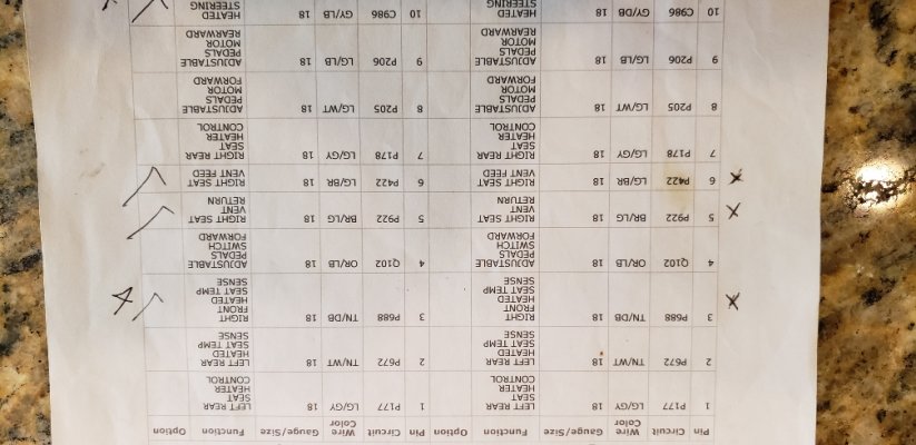

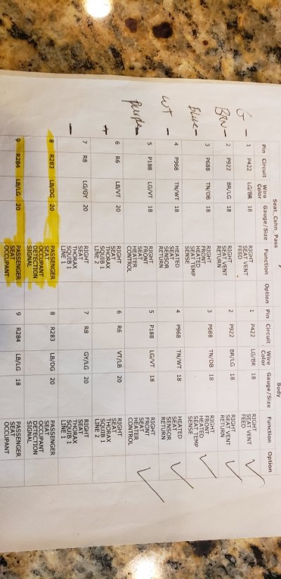

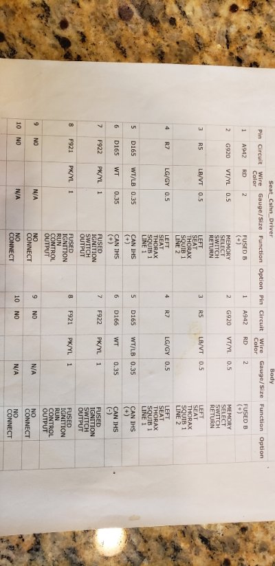

You should be able to wire it all up except the heated seats. You can either completely remove your original seat harnesses and seat belts and passenger side occupancy sensor if nessisary and install it in your new seats or you can de pin the connector in the new seats and see if they will physically fit in the 2012 seat connectors. It's really not to involved. The power adjust is the solid red wire in the yellow seat connector on both seats. You can easily run constant 12v power to it if your truck doesn't have the proper power wire. As far as the heated seats go, as I have mentioned before you cannot just wire them to aftermarket switches. They operate on a different type of system that requires the external Heated Seat Module to regulate the temperature. I would definitely reccomend just pulling the factory heated seat pads and installing a complete aftermarket system. Here are the pin printouts for thec13 to 18 seats
This is the passenger seat yellow connector. fed2d1772aedb57e7e5afa89b3ead9f6.jpg8aee58c167687745698922cef209eb43.jpg
Ricks Ram
May 1, 2015
4,411
3,417
Drivers seat yellow connector. 42d5b8eb8c3dfe34473b322bf2de33e5.jpgb622e6f599b2c5426ffeebe5633d84a1.jpg
Ricks Ram
May 1, 2015
4,411
3,417
Drivers seat 20 pin grey connector. Sorry those came out upside down for some reason. In any case you should be able to figure it out from there. Just a note in case you weren't aware the (Thorax) wiring is for the seat airbags. a3a1fc5e20c82b3eafb0df54358d2695.jpgb2e98fadb57d432d579dbf38a2159247.jpg
OnSale
OnSale
5th Gen Crew
Nov 12, 2016
3,218
1,730
Philadelphia, Pa
Oh wow thanks for the wiring schematics.
Now I just need to find the schematics for a 2012 regular cab.

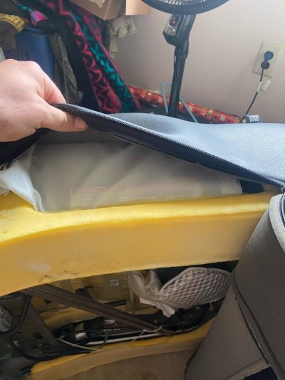

So if i open up my 2012 cloth seats and open up the 2015 sport leathers, would i be able to swap my srs air bag system from the 2012 seats over to the 2015 seats, and put it all back together and then i should be able to plug it right back into my truck and my truck will just assume i still have the original seats with air bags in my truck, correct?
My main question is, will the 2012 seat air bags fit and bolt into the 2015 leather sport seats?
Ricks Ram
May 1, 2015
4,411
3,417
Yes, this is exactly what I have been suggesting you do. Take the harnesses completely out of your seats with airbags, seat belts and passenger side seat occupancy sensor and install them in your new seats. You can remove most of the current harness from your new seats but you will need to leave the solid red wire in the yellow seat connector so you can attach a constant 12v power source for your power seat adjustment to work. The solid black wire is the seat ground but I have found the power seat adjustment still works when it's not connected. If you want heated seats I would reccomend completely removing the factory seat heaters and installing an aftermarket seat heater kit at the same time. Taking the seats apart is not hard and you can access the seat airbags through the zipper on the side of the seat. There are several videos on YouTube showing how to remove the seat covers.
OnSale
OnSale
5th Gen Crew
Nov 12, 2016
3,218
1,730
Philadelphia, Pa
Ok thanks. Anything I should know when opening the seats to remove the air bags and harness? Any tricks or tips? I’m going to order an aftermarket heated seat kit since I will literally have my seats open there is no point not too.
Do I have to remove any hog rings when I slide the cover up to remove the upholstery or can the air bag system be accessed without removing any hog rings. Just wanna know if I need to order stuff before I start all of this.
Thanks for all of your help so far [emoji1360][emoji1360]
Ricks Ram
May 1, 2015
4,411
3,417
Yes you will need to remove the hog rings to remove the old seat heaters and seat covers. The air bags can be accessed from the side by unzipping the covers but it would be much easier to remove the harness, seat belts and passenger side seat occupancy sensor with the covers off and seat cushions can be removed also. Your airbags should be identical to the ones in the 15 as far as how they look. I have done a few of them for other reasons and even though they looked the same the part#s were different so I switched them out just to be safe. There aren't really any tricks to removing the airbags and harnesses other than take your time and pay attention. Leatherseats.com has several videos on YouTube on how to remove the seat covers on Ram trucks.
OnSale
OnSale
5th Gen Crew
Nov 12, 2016
3,218
1,730
Philadelphia, Pa
Thanks.
I actually decided against installing heated seats right now. I want to reupholster these seats next spring/summer and figured I will do the heated seats then too. I already opened up both leather seats, and removed the air bag mechanisms. I did not need to remove any hog rings or really any parts at all besides 4 8mm bolts that were holding a support beam across where the top half of the seats lesther tucks under, and then undo the zippers on both sides and then the hard to reach 2 8mm bolts holding the air bag boxes in the bag, and the both came out.
Since it’s so late in the day, tomorrow I am going pull my seats out of my truck, bring them inside and remove the airbags from them, along with the whole seats wiring harness.
So I have to swap over the passenger seat occupancy sensor that is in the bottom half of the passenger seat? Does the drivers seat have one too in the 2012’s? I was surprised I didn’t need to remove any hog rings to get to the air bag box, can I access the PS occupancy sensor without having to remove any hog rings? Or will I have too? Is the sensor underneath the leather, or is it underneath the foam? I guess I am going to have to google that part to see what it even looks like lol. I’ve done a lot of stuff to cars and trucks, but this is my first time venturing into upholstery territory. I’ve made seat rail brackets for racing seats but never got into the actual seat material so this is all new to me.
Thank you again for all your help. Swapping over the air bags, seat sensor and seat belts will solve all of my problems of needing to wire stuff and plugs not matching. I didn’t know it was going to be easier to swap the parts then figure out the plugs and wiring.
Ricks Ram
May 1, 2015
4,411
3,417
Thanks.
It's definitely easier to just change the harness and parts. You only have an occupancy on the passenger seat to enable the passenger side air bags. The truck assumes that if it's being driven it has an adult in the drivers seat so there is no occupancy sensor on the driver's seat. The sensor is under the leather and glued to the foam. You can reach it from the back of the seat cushion. I'm not sure if you and get to it without removing a couple of hog rings but if memory serves me correctly you can. There is a possibility that your 12 has the same occupancy sensor as the 15 seats. If they are the same there is no reason to switch them as long as your harness will plug into it. The senor itself is just a flat looking piece of plastic with a pressure switch on it.
