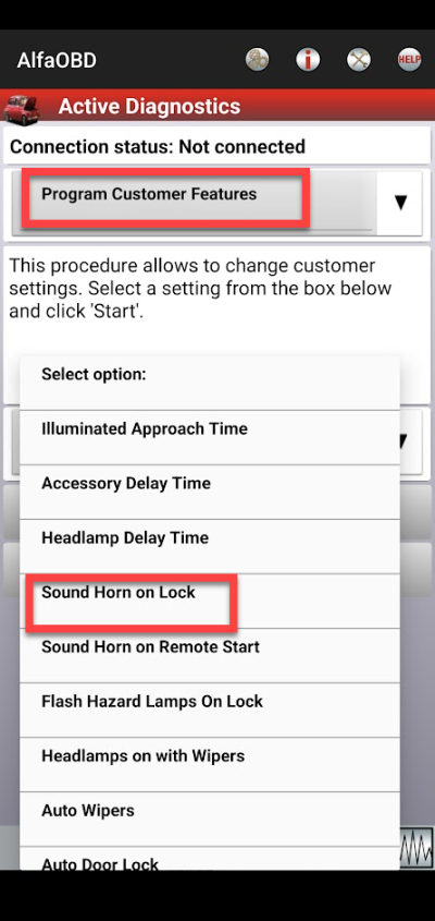

Looking at AlfaOBD under the only 2012 option,
"Central Gateway Module (TIPM CGW): MY2006-12 Non-Powernet",
the only horn option is the following;
