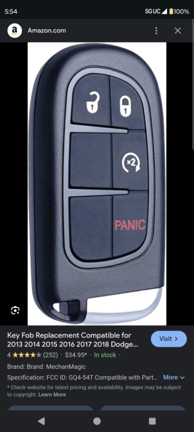

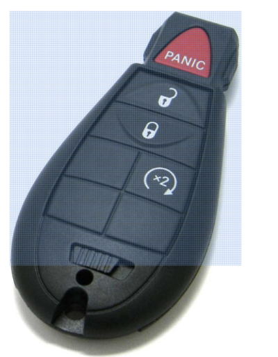

3 lock clicks sounds like an aftermarket remote start system. Maybe look up under your dash and see if you find anything aftermarket wired in somewhere. I doubt AlfaOBD would be able to do anything for you on an aftermarket remote start.
The OEM remote start has a separate remote start button on the FOB, and you only push it twice to remote start.
does your FOB have the little x2 button on it?
