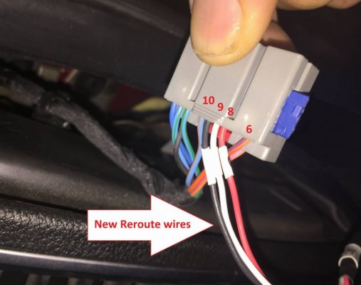

Remove pin 6 from the i340 connector (Lin Bus CBC 2). That should do the trick. Be sure to tape it up.

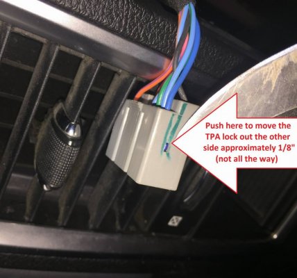

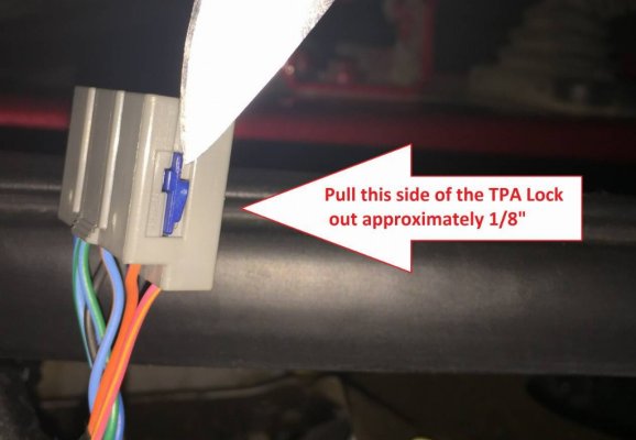

Don't slide the plate out all the way, only about 1/8". I didn't have these pictures before but it sounds like you figured it out for the most part.
