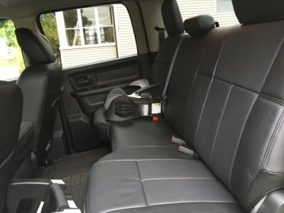

I have my new leather seat covers and want to take out the rear bench that has the fold up bottom. Does anyone know how to disengage the top or at least fold it forward? Any assistance or guidance would be greatly appreciated...

Clazzio leather kit. They fit awesome and don't cost an arm and a leg. I ordered all black and not custom. They had some pre made, 2 in black and 2 in gray, for $399
