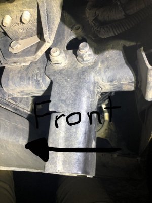

Now that I don’t need my resistors tied to my compatibility brackets for my LED foglights anymore, I’ve been thinking of removing them. They’re the lowest hanging point in the front of the truck, and I’ve bounced them of their fair share of rocks. Other than their purpose to keep me from riding up over top of someone in the event of an accident, am I missing any other potential protection aspect of them? Are they helping to protect any part behind them? They seem too narrow to really do much, and I’ve just had to keep repainting them every time I go out and slam them against rocks. They’re in the way and I want to get rid of them, but I don’t want to cut off my nose and all that.
For those that made it this far without knowing what I’m talking about, the compatibility brackets are just behind the bumper and hang down to stop you from rolling up on top of someone in the event of a front collision. They are commonly mistakenly referred to as a snow plow mount. Pic (not mine) for reference

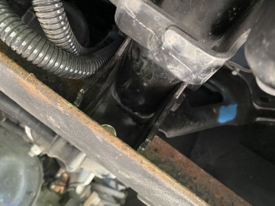

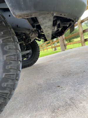

What I did to mine was cut them in half and added an angle iron 3x3-1/2 to them. I cut the 3/8 iron at 71” and went from one side of the bumper to the other, bolting on both ends and on the bracket. Now I have a new skid for the winch and a stiff front bumper. I also removed the gravel guard and it added a better approach angle and more clearance.

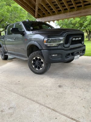

Well.... let me drive it a few days and report back (I’m “essential” so I still work) the removal of the gavel guard could create a air noise that could be bothersome.
As far as the extra iron goes, it will help on small front bumper impacts. The new brace does allow me a way to add an additional brace to protect the sway bar disconnect.
as far as looks goes, it appears I got a little lift just by removing the plastic.

I removed that plastic the first week of ownership.
No wind problems, even with the 37" added later.
And when the truck was at the shop ( you know, trail damage ) I ask them to remove the rear plastic with the parking sensors. Looks great and much higher.IMG_20200405_133041.jpg
