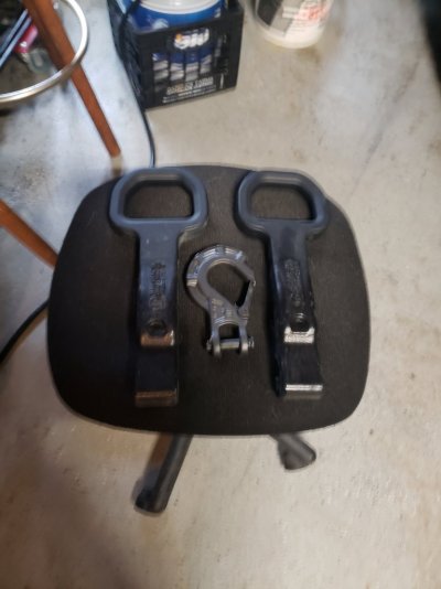

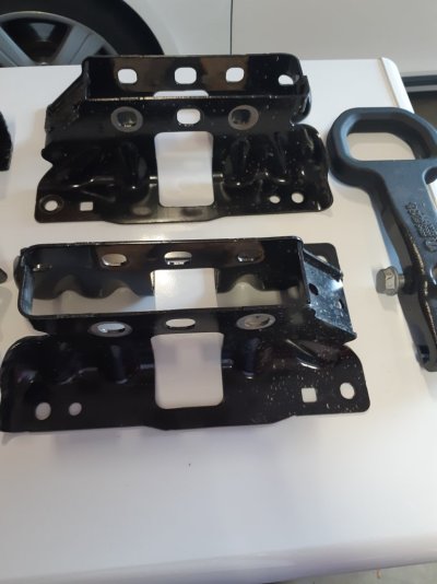

2500 and 3500, you have to take the bolts out completely. Tow hooks off my 2021 2500. We re-used the bolts to mount the Warn Transformer winch carrier for the Warn 16.5 TI, 16,500 pound winch.
