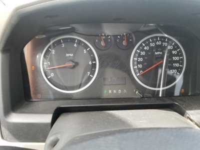

Hey guys, i took the dash off to replace the evap cooler and now a light with a truck and skid marks behing it, i dont know if its the traction control light since i can hit the traction control button and a different light comes on and says off. Took off today and drove and one of the brakes started to drag and you can feel it and smell it. This light im talking about is in the bottom right corner of the dash, the tsc light that turns off with the button is in the upper left side. Im sure if i didnt plug a sensor back in or if it is something with the traction control. I also put a new brake light switch on. The abs light is not on. Thanks guys

Get the codes retrieved. Did you accidentally mess up the brake switch pulling the dash? That would be my first guess.

I went to autozone hooked the their scanner and it didnt show any code. I put a new brake light switch on. Also the cruise control still works. The light im referring to is the bottom right light. That one stays on now.

You need an actual scan tool not just the code readers. It needs to be able to retrieve body, ABS, and communication codes. If the lights on there are codes set, I guarantee it.
