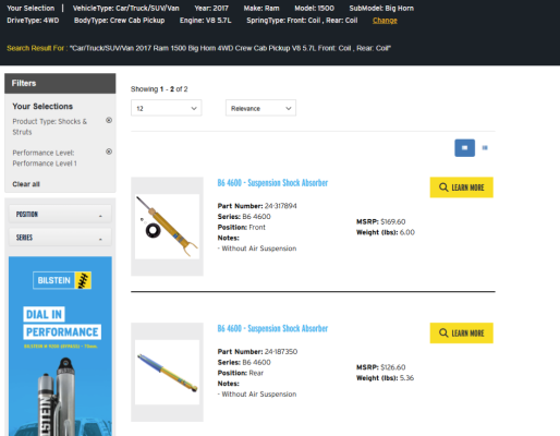

nlambert182
Dec 28, 2022
2,653
4,620
Huntsville, AL
OP has a 1500 so none of that is relevant. Both 4600 and 5100 can be set to stock height on half tons
Just telling you what Bilstein says... they say the same thing for a 1500 that they said on my 2500. Could you make them fit? Possibly.
mrack
Feb 14, 2023
710
1,003
Michigan
5100s and 4600s both have a stock height circlip setting. That said I don’t think I’ve ever heard of anyone actually setting the 5100s to stock as there are no other supporting mods needed to bump them up a couple inches.
