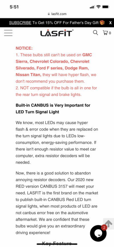

So in the fine print of some bulbs it’s listed that ram trucks don’t like the canbus compatible bulbs either no matter what and will require resistors.
