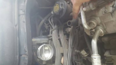

Got it, my PCV was pretty gunked up. Not sure if you can tell from the photo.
Could I use that line to run some seafoam cleaner through or is it too close to the MAF?
