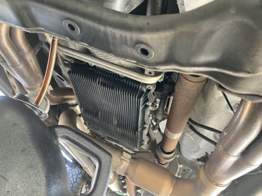

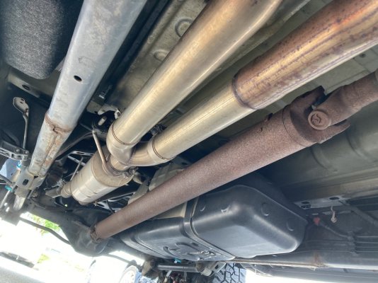

Headers, cat back, a open y-pipe & custom tune is where I’m at now, my tuner estimates around 420hp, was hoping for 450 or so but he informed me would need to upgrade cam to get close to those numbers.
Header setup looks nice. :favorites13: How's the interior noise level? Any drone?

I had briefly considered doing a true dual exhaust, & I’ll be the first to admit that I’m no expert, but have seen post’s from very knowledgeable members about having the right amount of back pressure.
Apologies to @Wild one if I’m remembering wrong, I recall a post saying a single exhaust setup properly, will deliver more hp than a dual exhaust.
Jan 17, 2016
23,896
55,047
14 Sport
A big single exhaust will generally make more power then a dual system will.
Daw14
Nov 29, 2017
3,434
5,498
South Florida
I do not know if you have access to the tv show Engine Masters , but they devoted an episode addressing different exhaust setups.
This is a good episode, like most .
And a single 3” out performed a 2 1/2 “ dual, hands down.
I watched it a couple times , to try and let it sink in my thick head. All the years taught to believe the duels were better , this shows differently .
