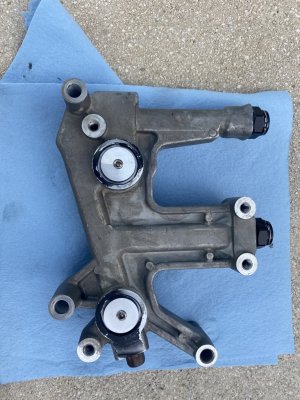

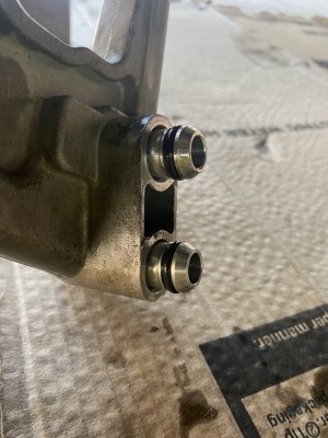

Working on it. You can see in the first 2 the hose switched over as bypass and then I cut some hose and used 3/4” brass plugs to seal off the hoses so no more bypass. It’s a royal pain to get this cooler out in the truck. What in the world... the hoses are cooked on for sure. Now the fun begins though. You can see in my last picture I had an oil leak... it was leaking from between the warmer blocking plate and o rings... for anyone wanting to do this please use rtv or just go the cheap route like I’m doing and pull the whole thing and tap the holes and plug them.

Look what I have... o rings... great. So I managed to get the unit out. Those clips are a pain. However. If you remove the 2 bolts that hold the trans lines to the transmission the whole thing will drop down and make it so much easier.

You have to block both holes. The plate is way easier,but you have to make sure you scrape the silicone off the heat exchanger,then apply a good bead of RTV silicone to the O-rings or the plate,when you install the block-off plate,or else it could leak.I don't think Khristopher applied any RTV to the O-rings or plate when he installed it the first time around,which might be a contributing factor to his leaking.The downside to doing it the way Khristopher and i are doing it,is there's no reversing the procedure Shaun,with the block off plate,you can easily go back to stock if you don't like it

Cleaned up. Tapped. Jb weld the plugs in. Time to let it cure.
A little heat applied to the area around the JB Weld will speed things up. I've got one of the bosses old hair dryers i stole when she bought a new one,i just propped it up,so it was blowing hot air on the plugs,not only does it speed up the curing process,it helps the JB bite into the aluminium better.

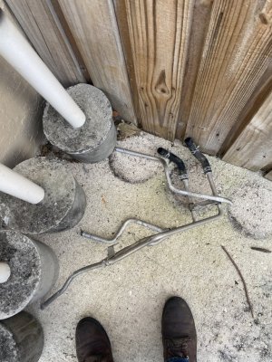

Yea you are correct. No gasket maker or rtv. I should have and overlooked it because of the o ring. However. I am much happier with this full delete. I do not want to go back. First tests already show that this is promising. I bought fast set jb weld. It’s the 6 hr cure. Already installed the unit back into the truck. Will come back out tomorrow and fill the trans with fluid. Also fully deleted the trans heater hoses. Not so gracefully. Lol. No going back now.
I thought about pulling the coolant lines,but i was thinking of trying to keep them in decent shape.Your way definitely is easier though,lol. I kind of want to keep the hoses intact,thinking somebody might need a set down the road
