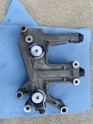

The bypass hole to route fluid to the exchanger is the very bottom hole in the inlet side bore,then there's a return feed hole in the return side of the unit,as you can see by CK's pic above. Both holes tie into the main body of the unit. The plate is the easiest way to block off both holes. The thermostat side of things would need a block off plug fairly long to block the bottom bypass hole,and would need to be shaped to still allow fluid to bypass to the cooler,definitely not an impossibility but it would require a fancy plug to block the bottom hole while still letting fluid flow to the cooler holes farther up the bore.To me it'd be far easier to duplicate the Rev Max plate and just take the stock thermostat out of the equation.Anybody with a water jet cutter can duplicate the plate.

It is amazing how similar the actual heat exchange unit looks like some fresh water boat cooling units I have worked with. Same shape and size. In the boats raw sea water is pumped to the heat exchanger where it cools the recirculating antifreeze mixture used in the engine. The raw water is then eliminated overboard through the exhaust.
I am not sure I like the plate deal. Seems leak prone to me. For your needs I like what you guys are doing with the total elimination of the heat exchanger and associated components.
For us seeking to go the inside passage so to speak, I envision a machined aluminum smooth plug on the end of a rod. The plug blocks the passageway to the heat exchanger and the rod seats into the end cap that is held in place with the C-clip. (The distal end, LOL) This would hold it in place. I don't see the need for any type of sealing devices like o-rings. Just a nicely machine fit should be adequate. Looks like the case is aluminum so by using aluminum you would not have dissimilar metals in play. The rod holding it in place shouldn't be any more restrictive to flow than the OEM rod and spring. When I say rod I picture it as being part of the plug. All being machined from one piece, not two separate pieces. Or, I suppose you could just place a spring in the bore to keep the plug bottomed where it needs to be and eliminate the rod portion. That would make the machining of the plug easier. The bottom bore looks smaller than the upper bore. I don't think I would trust it just sitting down in there without something holding it in though.

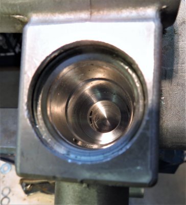

I think Caulk would need the whole unit,not just the thermostat. The thermostat seats against the top of the stepped hole in the bore,so to get the right length and diameter to build a plug that drops into the barrel of the bottom bore he'll have to get a diameter off the stepped bottom hole,and he'll have to measure up from the bottom of the bore for the length.The thermostat uses the bottom plate of it's design to seal the bypass hole off.I'm not sure if having just the thermostat to duplicate will give enough data to build the bore plug

If you go back to post 136 ,then compare to the inside pic of the bore in the pic on post #333,you'll see how the bottom plate of the thermostat seals against the machined lip of the top of the bottom bypass hole,that's why i think Caulk would need the whole unit,and not just the thermostat itself
Oh, I agree. Proper measurements with the proper equipment would be ideal.
At any rate, the housing in ones hands would be the appropriate approach. Too bad we did not think of this when you and Crazykid had yours off. Inserting the shank end of a drill bit into the bores of the passageway would have been an easy way to measure the bottom bore and the larger bore above it. The depth of the bottom bore could be determined even in the absence of a properly designed measuring device for the job. It would not be terrible difficult to make a rudimentary depth gauge for the job.
Looks to me like any method used to reliably block off the lower smaller bore would accomplish what is being suggested.

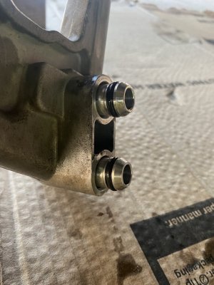

Can anyone indicate the fluid flow direction on these ports? I'm curious on the in/out and flow direction.
