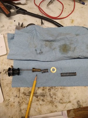

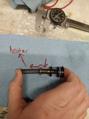

Ok, I've received the stock thermostat from crazykid1994 and had a look at it. Here's a couple pics showing how fluid flows through the housing given the information I have. First is when the fluid is hot, how it flows toward the cooler. Next is how it flows cold toward the heater.
Last is the thermostat assembly all broken down, I now have a plan for what I'll make. The plan now is to replace only the thermostat portion itself (I'm pointing at it) and reuse all of the other pieces.
