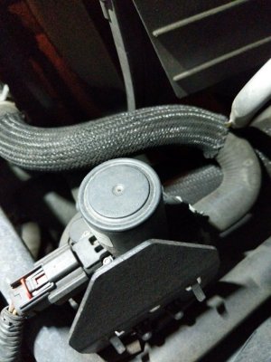

My other thought is you might have a unicorn,it's not uncommon in FCA products,lol.You're truck sure has me scratching my head,as it's definitely not running normal temps compared to other trucks.Can you see if it's still feeding coolant to the heater.There'll be a funny looking 3 way valve mounted on the pass side frame rail,basically under where the stock airbox would sit,can you take a pic of it,as i'm wondering if the coolant feed to the thermal unit might be bypassed.

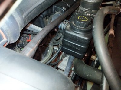

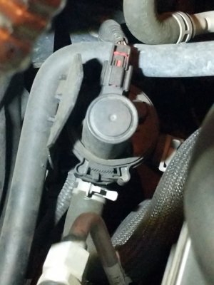

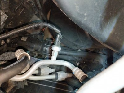

Ok, pics, 3way valve, Edelbrock electronic water pump Edelbrock supercharger coolant reservoir pics of hoses not certain where they go

Well by the looks of your pics the hoses to the tranny heater appear to be still hooked up.The Edelbrock water pump,is only for your intercooler,has nothing to do with the trucks cooling system,or the tranny.All it does is circulate it's own coolant to the intercooler which is part of your Edelbrock blower,it won't cool the engine or the tranny,all it cools is the intake air after the blower compresses the air fed into the engine.By product of compressing air is heat,and the water pump you see is the pump that circulates coolant to the intercooler under the blower to combat that heat increase in the incoming air charge.

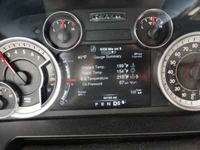

It would depend on if it's stuck in the fully open position or just partially open.The thing that's a bit confusing is the fact he says it warms up to around 190,then starts to drop back and with a longer drive settles in around the low 150's. By the looks of his plug covering the thermostat,the snap ring looks to never have been disturbed,which backs up his claim it's still a stock set-up,and his hoses to the thermal unit,look like they've never been touched either.He does have an early 8 speed by the looks of the date on his thermal unit,which makes me wonder if he does have a unicorn on his hands.I really got nothing,but i agree with him,i wouldn't want to screw up what he's got,as that's almost an ideal tranny temp in my opinion,lol

I agree on the ideal Trans. Temp. I would love to see in the 150's. I wonder if the thermostat used on his truck ( transmission bypass thermostat that is ) might have a different Temp. set point when to open and close. I think Caulk mentioned that the part numbers were different for Bigskyroadglide's truck than later years.
