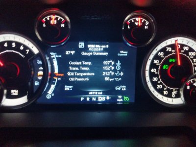

Ive been following this thread for the last few days. Thought I would post up my 8 speed temps.
I drove from Virginia to Tennessee last night, here's a photo about 200 miles in.
RCSB, RWD, supercharged 5.7 with 3.92
Once warm, I rarely see more than 160

If that's a stock HP70,you definitely have a unicorn on your hands,as most of them run 180+ tranny temps.Were you the guy that found that truck on a lot a bit ago? If so i'd almost wonder if the tranny thermostat has been played with before you bought it.

I'd lays odds the thermostat on that tranny has been tinkered with,or else the temp sensor is haywire.No way it's going to run at 152,when the tranny thermostat on a stock 8 speed doesn't open till it hits 180 degrees,so something is up with your tranny.Next time you're under it,look real close at the gap between the heat exchanger and the cooler bypass part of the thermal unit.You're looking for a thin flat plate about an 1/8" thick.Also look and see if it has a brass plug where the thermostat goes.

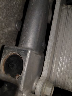

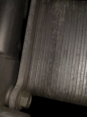

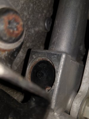

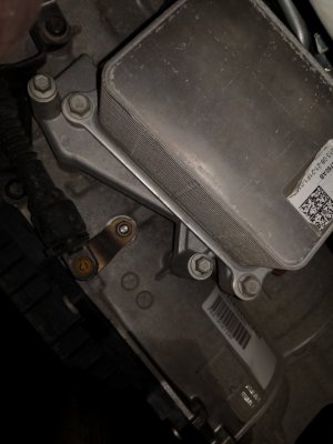

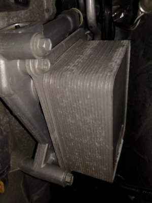

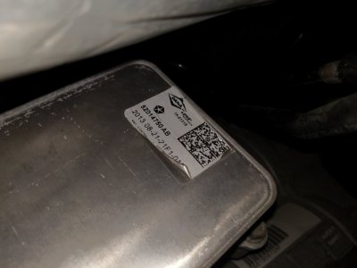

Alright, see multiple pics below, I don't see any brass
Ignore the fluid leak, I was fluid filming today and got some on the transmission
caulk04
Supporting Vendor
Mar 24, 2013
1,101
2,434

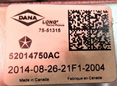

Interesting. Definitely a stock plug on the thermostat housing. How many miles does it take to go from cold start to 150 where it levels out?
A quick Google of the part number shows it was used only on 13/14 trucks and was replaced by another number, not just a new suffix (AB, AC etc) as is normal for revision changes in Dodge parts.
My 14 is the same part number except mines a AC revision
