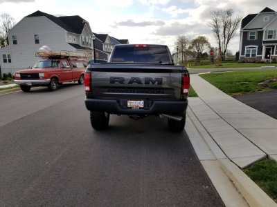

I would hate any kind of rubbing. Which one of the 2 offsets would be better for no rubbing?
The lower the number, the farther they will stick out. You want the +18 offset. Any negative offset will stick out farther and rub when you turn the wheel, unless you have it lifted above stock height. My wheels are 18x9.5 and +6 offset with 35s. Check the pictures on my build page. A +18 will still stick out a little. The stock wheels are +47.

Yes it all depends on offset. If you go with +18 or higher offset u should be ok. Whether the wheel is 20 or 18. The size of wheel doesn't matter as long as both are same width with same offset.

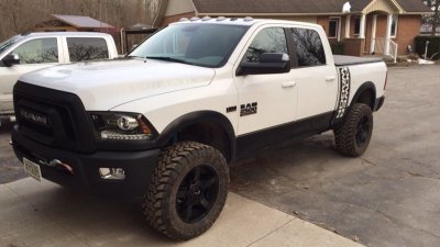

Here are some pics of basically what you are proposing. 20X9 Rockstar II with a +18 offset. 35" Toyo M/T
I can post more pics if you would like. But the +18 offset will have the tire stick out about half an inch from the stock flares and the only rubbing I"ve experienced was turning full on a down grade going backwards. That has only happen twice and i cant seem to get any rubbing when going forward, even with the sway-bars disconnected and turning. hope this helps
