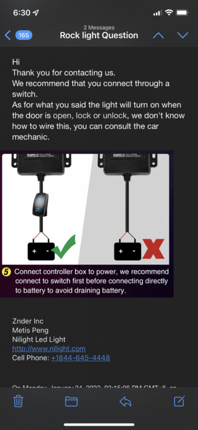

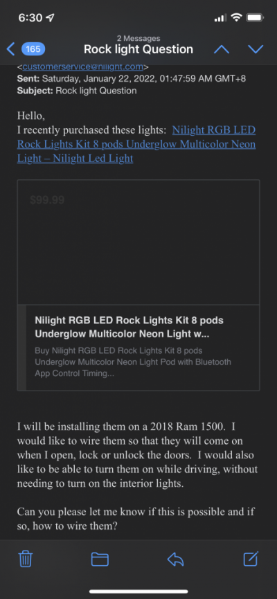

Well. That was pointless. Guess I’ll see what happens when I hook them up. Going to wait till it warms up though.
