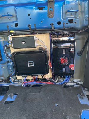

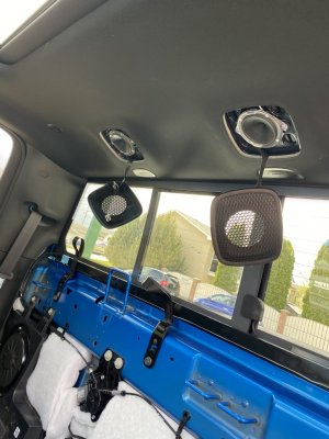

Well I got this all done except the front door speakers. Waiting for them to arrive. Sounds amazing now. DSR1 mounted perfect under the drivers seat in place of the factory amp. Punch EQ works perfect through the speed compensation setting.
