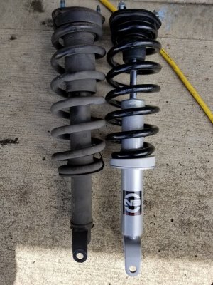

Had Rough Country 2" levelling Coilovers installed yesterday.
https://www.roughcountry.com/dodge-leveling-struts-500028.html?find=2014-dodge-ram-1500-4wd-566676

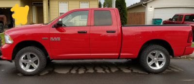

Measurements front wheel well with 275/60/20, before:
36 7/8" both sides
Right after lowering down:
40" both sides.
After it sat overnight:
39 1/2"

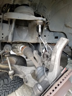

So, at this point it appears that, I got about 2 1/2" of lift in the front. I am certain it will settle some more, which would be good. I will have alignment done tomorrow. Overall, pretty happy with ride quality, ease of the install and price. New strut is about 1 1/2" longer than the OEM. At this point I have not replaced UCA. Not, sure if I will. Still have RC rear shocks being delivered. Didn't have the before pix, only the after ones.View attachment 206064 20200504_200225.jpg 20200504_145312.jpg View attachment 206064

Don't know if it's a camera effect but the springs in the RC struts seem to be a little ticker too? That's pretty good they're tad longer too. thanks for posting and best of all, Enjoy them.

Doesn't being longer reduce the travel?.....similar as adding a top strut lift spacer?

Not necessarily, we have to know what the minimum compressed length is. For example the usual 5100's for our trucks are 0.34" longer than KYB stock replacements, but they're also 0.43" shorter when compressed.. so they show a possible gain of around 3/4" at the strut which translates to around an inch of potential travel at the wheel. We'd have to know what the compressed length of these are before we can talk about a change in overall travel.

Adding the spacer at the top relocates the physical strut mounting location down so you're making the shock longer on extension, but shorter on compression by the same amount as the spacer on top . If you add a 2" spacer at the top of the strut you'll gain 2" in downtravel, but lose 2" uptravel.
In this case the shock is longer on its own and the shocks mounting points are still at the same height, so you have more downtravel cause the shocks is longer and your uptravel will be limited by the bumpstop when the strut compresses in full which can be same as stock or my guess 1" long.
As explained above by Kurek we don't know what the strut extension/compression values are, but judging by the pic and the reference the OP made by saying they're 1.5" longer, you should have more downtravel with them with the truck sitting at say 2-2.5" of lift so that'll make them extended travel like King, Falcon and others etc. Because they're longer than stock it wouldn't be a good idea to add another spacer at the top cause you'll be over extending something that is already 1.5" longer the stock. plus with extended struts like that you want an aftermarket UCA that can droop to use the extra length in the shaft and won't bind at full extension etc.
Hope it makes sense.

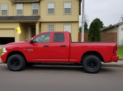

They settled, maybe, another 1/4", if that. So, the front is raised about 2 1/4" from stock. I have driven 1000 miles or so. That's where it's at. I like how it drives and looks. No drastic improvement from stock. But good nonetheless. I would buy again.

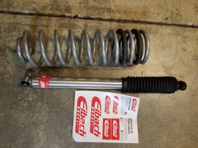

Just finished upgrading the rear end with Eibach 1" spring coils and 1.5" rear shocks. I like the truck to have a little rake. That achieved it for me. Also, impressed with Eibach quality. I've had Bilsteins on my other vehicle before and I feel Eibach is a way better ride.
