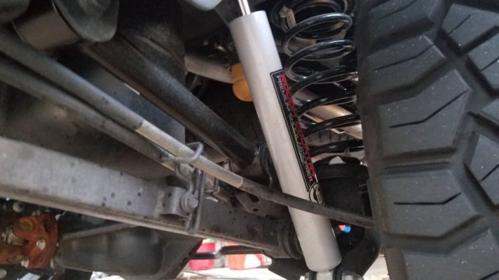

I have a rough county 6"lift paid 2k came with RC shocks ride is perfect. really wish I went 8". a20288332a70af0cf030c2cff7a693ce.jpg56388da0b3931316685b5025be2a2570.jpg2833bddadd72d71f9bee7a48ba12ea3f.jpg

@8732cuts Check me on this, but somewhere in my research I read that the rough country shocks mount Barrel up. Meaning your rear shocks are installed upside down. I’m not 100% but check your paperwork that came with them it should have the appropriate mounting direction in it. Very nice truck by the way[/QUOTE]
[/QUOTE]Checked the truck nope the in right. Thanks getting ready to put cold air intake, borla exhaust.
Sent from my SM-N960U using Tapatalk[/QUOTE]
Cool I remember thinking that mine were installed wrong and then reading they where opposite the rough country shocks
