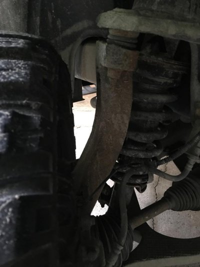

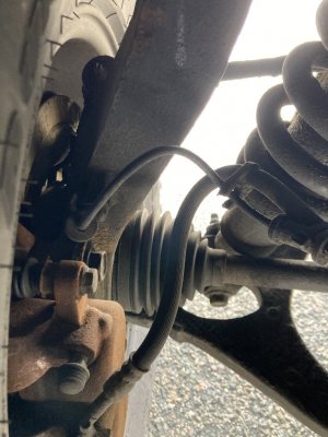

Not sure if this will be helpful or not, but here’s a pic of mine. 4”RC lift, stock 20” rims, and 35x12.50’s.
The first pic is with a 1/4” wheel spacer installed. Without the spacer, the tire was rubbing on the knuckle.

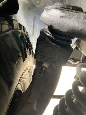

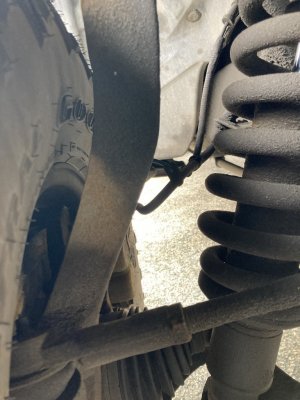

This pic is with a 2” spacer, same wheels and tires though. With the correct back spacing, I don’t see any reason why you couldn’t run a 17” wheel.

i know this thread is a little old but are these pics with the 17s? what back spacing do you have? i'm looking to install spindles as well,mine is 4wd with 17x9 with 4.5" backspacing (-12 offset)
Yup those are 17's, same specs you're looking to install. One thing I'll note, the beefier TTX tie rod ends wouldn't clear when I tried to install (rubbing the wheel weights)
