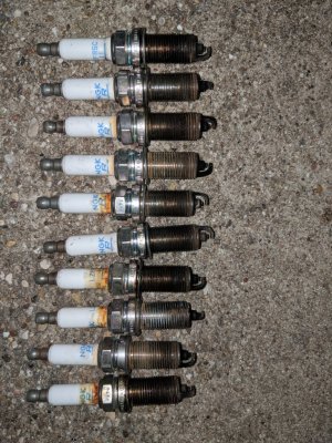

I was able to replace most of the spark plugs last night, still got 6 more to replace. Here's a photo of the old spark plugs. I've been replacing them with NGK (LZFR5C-11) plugs. I believe they are copper like the last ones.
The o2 sensors were ****** up and fried and I had the truck running rich for about one-two months, idiot mistake, I know better now. I'm pretty sure that's the reason for the misfires because the engine ran rich and had fouled up the old spark plugs.

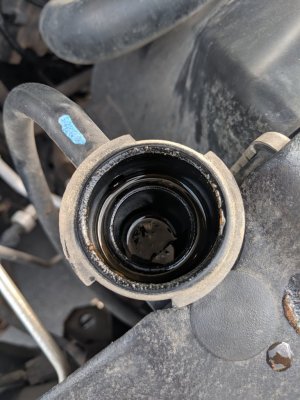

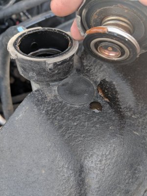

Also I decided to check my radiator and found this...
I'm assuming I need to flush it, but I'm guessing this isn't the problem for the misfire.
