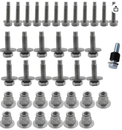

Does anyone know what size riv nuts are required to install the factory running boards on a 2024 3500? I have all the bolts so I don't need the whole hardware kit.

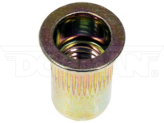

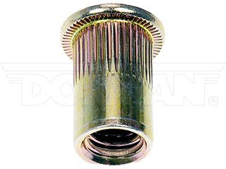

I believe that the Rivnut for your Ram, will be
NUT/RIVET. Hex Drive. M8x1.25x17.78. Mounting.​
Mopar Part Number: 06511062AA
Supersession(s): 6511062AA
I don't know if Rivnuts come in different hardnesses.
Personally, i think the hardware should be Grade 8,
but you might chose Grade 5 hardware
chances are that 12 are needed, buy a couple extras
in case the threads are messed up
Good Luck

The rivnets are hex holed $20-25 on amazon
"2015 ram step rail hardware"

I was hoping to just buy the rivnuts since I have everything else.
