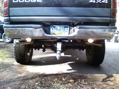

I added lights on mine bc backin up at night, with a lifted truck, and tinted windows is not a good time lol I got those work lights used for like tractors, etc. I mounted them sideways on each side of my reciever hitch. Ran a 14gauge wire from there into the truck through the firewall to a switch mounted down by my 4wd shifter on the bottom of the dash, then back out and directly to the battery so that i can use them even when the trucks not on.
