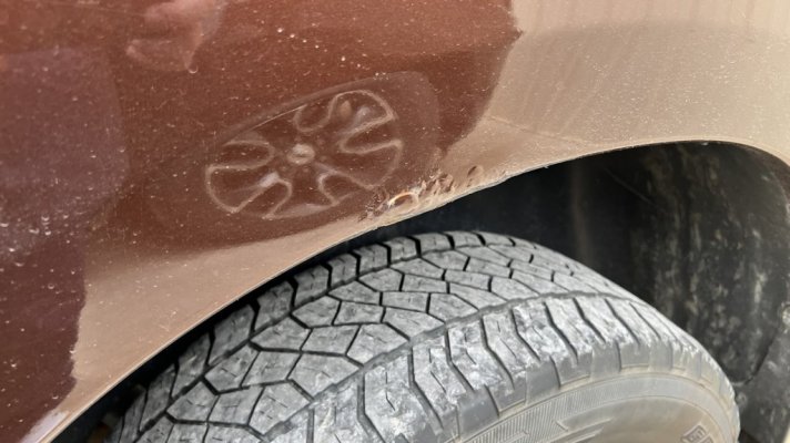

So yeah, as the title states, I have some rust popping up on my 2013. It is above the rear wheels and a little worse on the left side. I took it to a body shop guy and he said that the bed had a reinforcement above the rear wheels and it tends to hold dirt, mud and salt. He estimated over $5000 to repair correctly by replacing both bed sides and reinforcements! I am getting a second opinion but this estimate is awfuly scary! $5000 + for a truck that is almost 10 years old? Should I even fix it or try to trade it off before the rust gets out of hand?
Here are a couple pics of the LH rust bubbles...
Here is the rest of the unmolested truck!

Does that small spot really bother you enough to pay $5000? If the rest of the truck is solid and still runs/drives like it should I wouldn’t even worry about a spot that small. If your that set on fixing it you could sand it down and put por15 over it then a topcoat, not going to be perfect and the rust will come back in a few years but sure beats $5000 on just a tiny cosmetic issue.

Its a rotten shame the way the fenders rust out on the bed. They all do it. There is a huge brace in there that traps dirt. Convenient. I would try another shop and see if you can get a better price on the repair.

That does seem like a lot of money to fix what you have shown us in pictures. Does it actually need both complete box sides, that seems excessive. The price of trucks and the shape yours is in, i would try to find a repair shop equally qualified for less money to do the repair. If the repair lasts only 2 or 3 years, that is 2 or 3 years you get to enjoy your Ram more and giving you time to decide on any investment for something else. Maybe in a few years look for a complete box, used, that is great condition and then painting to match. Personally, i would fix it before spending 10's of thousands on another vehicle.

Anothe school of thought, do nothing for now. If it gets bad enough, most likely it will, replace the bed with a clean one from a wreck. Have it painted and install.

Just get a rust free bed and replace the bed, there are or at least were a few places around where you live that had take off beds.
It's possible covid closed them all though.
If not used is about 1500-2500 dollars depending.

I would invest in a set of body color factory flares like on the larmine. Pop them on and ride it out till I could find a replacement bed instead of repairs. The flares and paint will set you back probably $500, if you source the flares used, they use the factory holes and double sided Tape.
Treat the spots with rust treatment , fluid film the bed inner sides
Should give you a few more years.
