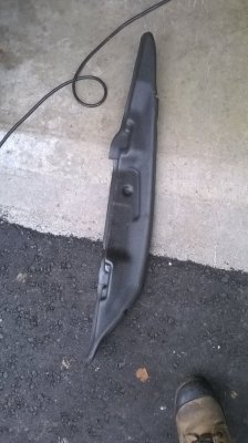

I agree with Chris , no way in hell these rustproofers are pulling the plastic wheel well liners
That would cost to much on labor

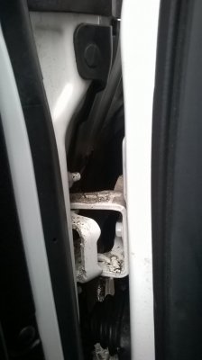

The foam piece is just an air dam behind the front doors , you can have it out in seconds with the wheel liners pulled - You can see the foam piece in this picture where the body line runs up between the door and fender - It just sits in place
Now
However this epoxy coated fiberglass mesh piece actually strengthens the front fenders from behind
That’s where your corrosion starts , between this mesh piece and your actual fender - And it isn’t coming off , unless you have a blow torch and a grinder LOL - It is adhered to the fender for added strength and it is permanent , it’s not foam and it’s rock hard
That’s why the front fenders must get replaced

I looked through the door into the fender area and all I have I believe is the piece of glued foam/mesh and nothing else. I was able to push aside the small foam piece between the door and fender and there was nothing there impeding my vision directly into the fender. This truck has been well undercoated since new and when I looked in that area, it was clear to see the inner fender was completely covered with Krown and/or Rust Check product. The foam/mesh piece stops the product from getting in behind it and I have heard, getting this piece off is almost impossible?
That’s where your corrosion starts , between this and your fender - And it isn’t coming off , unless you have a blow torch and a grinder LOL
Mine has been sprayed with Fluid Film more then once
I believe that is the only piece have behind my fenders? I could clearly see in there when I opened the front door and had a look. There was a piece that ran at the back of the fender between it and the door but I believe it was a long strip only?
After I sprayed more in there, I could see it but I could also easily prior to me spraying in there that it was well covered from previous applications over the years. The products, imo, will not get in behind this glue/epoxied foam/mesh.
It's a crappy design and I am sure FCA/Ram is regretting it bigtime putting those pieces in there!

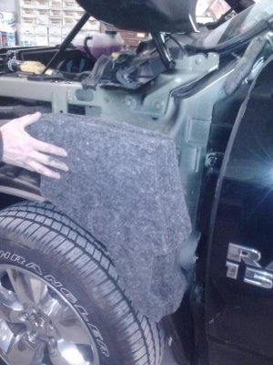

0F042566-EBD8-4E3D-8A76-524E9319CAA7.jpeg I saved this picture years ago
My 2011 didn’t have this sound deadening pad - I don’t know what year Ram this picture is from
I also don’t know if certain trucks got these pads or not , but if they did , man what a moisture holder
I was also told certain years again , might have crap like this in the rear quarters - Again my 2011 did not
I am glad I pulled my wheel well liners when the truck was brand new , sprayed fluid film because if I would have found crap like that , it would have been removed instantly

View attachment 147755 I saved this picture years ago
OMG what the HELL is that !!!!!!!!!!!!!! Must weight about 30lbs wet and never dry out?????????????
I don't believe my Ram has that big piece of insulation that Bee posted either but it's odd that I have rusting issues coming through above/around my Hemi badge? I know I have those other pieces, like what was posted on pg3, (pic below) as I can see those while looking in there.

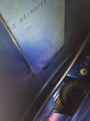

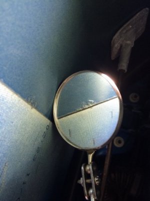

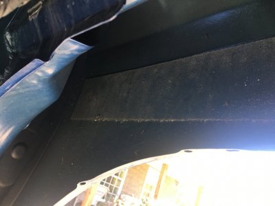

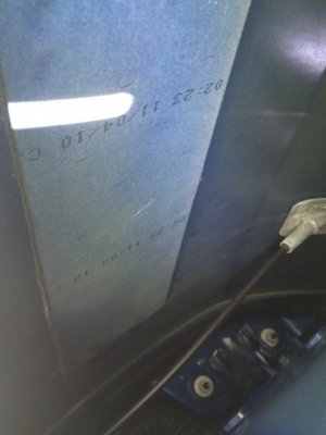

1E26168A-0952-4E4E-AD91-AA2AD6513D9A.jpeg C9F87005-0028-4BAA-A77A-8DF9637070A0.jpeg 358DE828-748D-46C9-9C0D-124EB2CC2556.jpeg Pictures before I sprayed fluid film years ago
I can state for a fact
While running my hands across this fiberglass mesh patch when new , whatever adhesive was used to attach it to the backside of the fenders for strength is permanent and very strong
However you could feel air pockets , or soft spots in the patch itself , just small fine areas like either the adhesive was missed in spots or didn’t adhere to the fender
Got me thinking if
A) Moisture could have or get trapped in those spots
