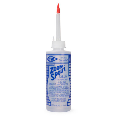

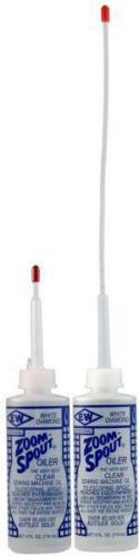

If you get a bottle like this (below), it has a long pull-out spout ...longer than most, which you can insert up door drains, tailgate openings, and all other locations. etc. You can buy these at an HVAC supply place for a few bucks ...or like ebay, etc. Fluid Film and Rust Stopper ..you can buy locally at Farm n Barn places or NAPA ...and they usually have a straw that'll shoot in a ways.
