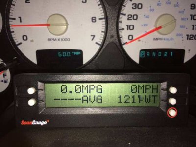

I would suggest you read some of the hypermiling forums and buy yourself a good computer like a scan gauge. I have one in every vehicle I own. The forums are a wealth of information and they are really helpful as to what is safe for which vehicle etc.

I too have Scangauge IIs in all my vehicles. It pays for itself in a month or two so why not? Instant MPG feedback I think is very important. I have a 67 mile one-way commute to work so getting good fuel mileage, as well as being able to haul/tow stuff, is very important.
