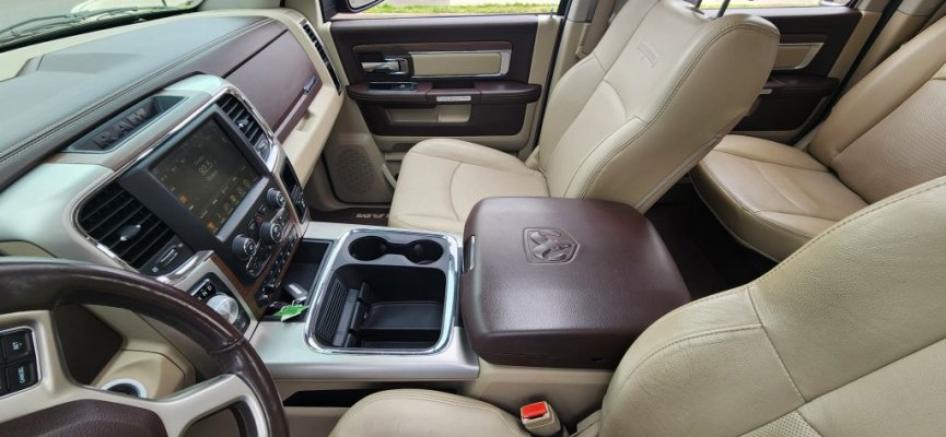

Not sure of your setup, But my center console arm rest has 1 usb power, and in the center main storage there is 1 USB port. The one in the main center storage
