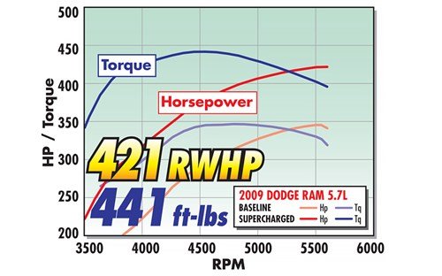

BlackRamHemi - in a theory, you are right. But if we compare some graphs (kickng off the accuracy):
Screw charger:
http://www.youtube.com/watch?v=KCQQSjOuRyA
proof:

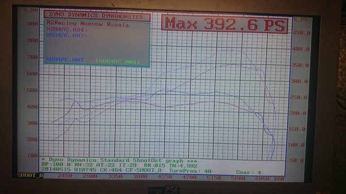

Procharger, recalculated +20% on the motor:

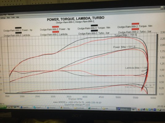

and this is mine (not stock, but not charged):
it seems that difference at lower rpm is not critical (anyway +104 lb/ft is not going right at 2000 RPM) but at 2000 rpms the transmission and TQC are already locked - this means it must hold all the power it is limited for. Moreover at 3500 rpms we have:
340 lb/ft, 230 HP - my modified truck
370 lb/ft, 250 HP - procharger
340 lb/ft, 225HP - screw compressor
At 5100 RPMs:
380 lb/ft, 385 HP - my modified truck
430 lb/ft, 420 HP - procharger
415 lb/ft, 410-420HP - screw compressor
I know, the accuracy of the numbers is a big question, but here we can see the tendence. I just want to say that turbo and centrifugal chargers are blowing too hard at the spinning, they load the trans at the rush higher then displacement blower. Generally the question is what is worse for ZF - a bit higher low torque or quite higher rising torque at higher rpms. As I wrote, the example of friend of mine with procharger showed the second one.
p.s. I can mistake, this is just a thoughts. And this thoughts are just about RAM truck only. And I cannot understand why the SRTs with same trans driving quite good with displacement chargers.
