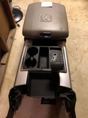

IMG_0248.jpg If you ever decide you want the console, I have one with the shifter and dash bezel taking up space in my basement.
