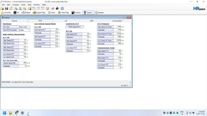

What temps is everyone running after doing the 180 stat/V6 E-fan swap?
Right now on my Trinity T2 tuner the (3) three settings (AC off high, low, AC On) are at 215.6. I have Hemifever who tuned for the 180 stat, however just installed my V6 Fan yesterday. What are the ballpark temps of the fans set at?

195 is where my temps are set to turn on,and i think 190 off Lyle

Oh, thanks for the reply Rick. I got ahold of Brandon and he gave me AC on 175
AC off low 175 and AC off high 180 temps. I have those set right in in the truck. If it doesn’t go well with those temps, I’ll try your suggestion. I haven’t gotten out to drive it yet.

Those are too low for a 180 t-stat Lyle,the fan will run constantly even going down the road on a cool day. Try them out,but i think your fan will run pretty well constantly.

Sorry forgot to ask, what would the AC on/AC-Off high/AC-On low be set to with the numbers you provided Rick?

Well was told by Sean that he already set the temps for the 180 stat and I don’t need to change anything for E-Fan. He said the e-fan will compliment the 180 well. I noticed the temps were set to 215.6 across the board when I look at them.

That's a little high for a 180 Lyle.Most tuners usually set the fan temps about 195/196 with a 180 t-stat

Rick is right as usual.............all the tuners I talked to say efan settings should be set 10-12 degrees over the 180 thermostat........a 180 opens at 185 so 10-12 over that would be 195-197
That's why I'm at 196.......right down the middle........LoL

Well it’s set at what Rick suggested idk want to doubt my tuner but since Rick says so……..I guess I should be paying him what I paid my tuner lol it’ll stay where she is now.
