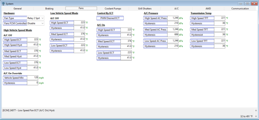

Next weekend I'll be installing a V6 fan (removing the clutch fan) and installing a 180 t-stat. I have some questions on tuning that I can't quite wrap my head around. I've talked to @Mojo88, searched here, AND on the HPtuners forums. It appears (screenshot) that I don't have a PWM fan, but a relay setup from factory. Once I make the swap, what do I actually need to change in HPT to get the fan to come on at the proper temps?? 1746403903672.png
