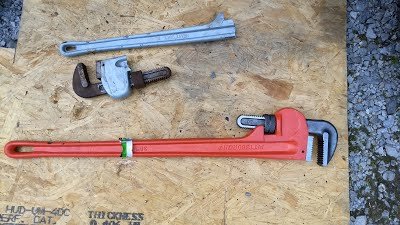

A couple days before I use a big ass pipe wrench to bent the mower blade back into shape. It is just a matter of leverage. The pipe wrench I uses was actually sitting on the porch. I grabbed the pipe wrench and had it clamped at the top of the brake rotor (mounted backwards). I went and got my sledge hammer and stood back and gave it a good whack; which snapped the aluminum handle off. The bearing hub didn't budge.
I thought about it for a minute. I'm not surprised the wrench didn't live though it. I need a all steel pipe wrench, a bigger one. Harbor Freight has these fairly cheap. So after church Sunday I headed to Harbor Freight and picked up the biggest pipe wrench they had. Had a 20% off coupon so got it for about 25 bux. When I got back I placed the new wrench on top of the brake rotor. Stood back and hit is hard with the sledge. To my delight it worked and the hub popped out and fell to the ground.

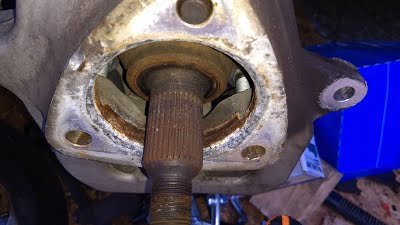

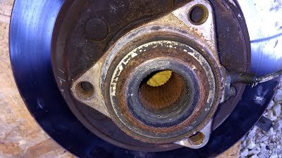

Examining the mating surfaces you can see the corrosion that had it seized in place. Aluminum steering knuckles are used because with independent front suspension you need low mass for quicker tire rebound. Well, the hub is steel, so bolting 2 dissimilar metals together you get electrolysis and that is corrosion. IMG_20190729_075721698.jpg IMG_20190729_075705184.jpg
A simple solution is to add some anti-seize compound to the mating surfaces at the factory. But they don't do that!
A quick wire wheel cleanup and some anti seize will make the new hub go in nicely. Hopefully this is the last time I have to take a sledge hammer to my RAM pickup
waste of a perfectly good aluminum pipe wrench .. hope that wasn't a Rigid :-(
You should have tried a long cheater bar on the pipe wrench first. I used to use a 6' cheater on the handle of my 24" aluminum pipe wrench all the time, if it didn't come apart, something usually broke and it was the wrench.
Don't cry for that pipe wrench, that was a cheepy from HF. I stood on the pipe wrench handle and it didn't budge. Took a shock load to break it loose.
