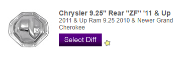

just checked randy ring and pinion.
https://www.ringpinion.com/DiffWizard.aspx
made one mistake. the cross over year for the new front diff was model year 2012 as in it has the 215 mm gear.
so if you buy a 2011 it will have the old 8 inch front but still have the ZF axle rear.
