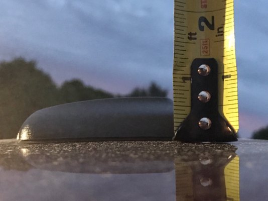

My truck has a readylift sst leveling kit . 3" in front and 2"in rear . If I decide to go higher in the future my "shark fin antenna " will hit the header of the garage door... anyone swap it for a low pro??fc8d72532dcaf1b8cdd5293edb4d09f0.jpg

Excuse my ignorance, but is the shark fin for the radio or satellite radio?
I think my sat radio antenna is flat, I'll look when I go out to the truck in an hour but couldn't see it from my desk. If for sat radio maybe a different one from a earlier model like my 2011 will work?

Just looked, guess mine is taller than i thought. Its not flat
Sent from my SM-G920V using Tapatalk
If it doesn't have that huge 2+inch shark fin then it's much shorter than mine and would allow for some more clearance.
Ill snap a pic once i get to tge store
It's significantly shorter. Definitely less than an inch - I'd say probably around 5/8".

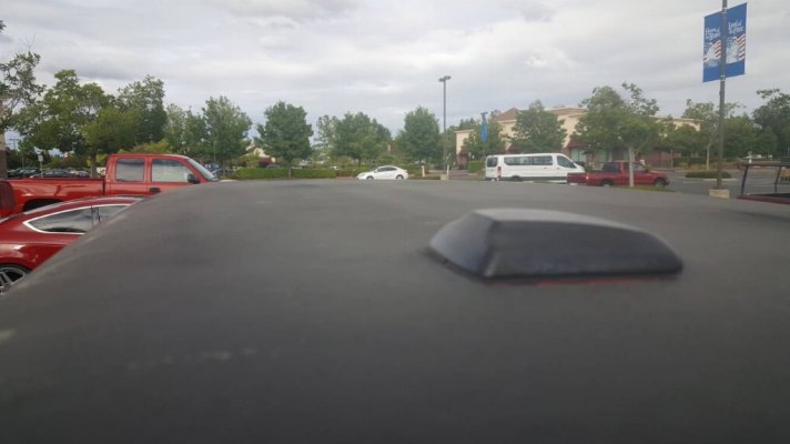

The antenna swap is fairly simple , a few here have upgraded to the shark fin from the puck style antenna.
Regardless of where your antenna is located all you have to do is drop the overhead liner just enogh to gain access to the antenna . The overhead drop is straight forward when you look at it ..A.B & C pillars , rubber seals and sun visors and overhead console are the only components holding the O/H liner up .
Seems like a lot but whether your Antananarivo is in the back or front of the cab you can have access to the antenna in 10 -12 minutes.
I will caution you to wear latex gloves and peel back the black rubber seals and apply a painters masking tape to the head liner to prevent getting the black residue on the light tan headliner .
As 00R/T eluded to above you will need a 911 delete plug aka fooler plug (from M2Mods a vendor here) so you do not get the " phone message " on the radio.
You will have only the mustard colored plug hooked up to the puck antenna , just tape the purple plug & cable down so it doest rattle .
The mustard color plug is SXM & GPS , meaning you will still have Sirius & Navigation.
Fwiw I've upgraded to the RA4 8.4NA radio , I have the puck style antenna and the fooler plug installed , the fooler plug acts like a stub antenna and it is plugged directly to the back of the radio , I still have the Sprint 3G coverage and my 911 / Assist functions work 100% on the mirror buttons and radio.
If you have a Uconnect access apps account , you may loose the ability to interact with some uconnect apps or have a weak signal.
Hope this helps !
