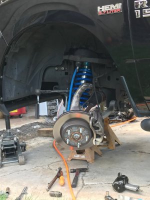

I did the Zone UCAs and had custom springs done by Deaver (they’re local to me) back when I did the Bilsteins. I had a master mechanic friend do the install for me. He didn’t mention any issues with the install.

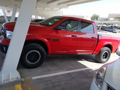

i am ordering the kings 2.5 with Total Chaos UCA to replace my Bilstein 5100. did you experience any rubbing with 35s? I run 315/70/17 with method wheels 0 offset/4.75 backspacing. I am an off-roader.

thank you.
I was really worried because Bilsteins give 2.8" height, while the Kings are 2"to 2.5". I will proceed.
Here is my car with 5100s, will post the kings 2.5 as soon as I install.

That don’t look like a car. Looks like a badass truck to me. [emoji38]. I like the red.
Blue Streak Pearl off-road

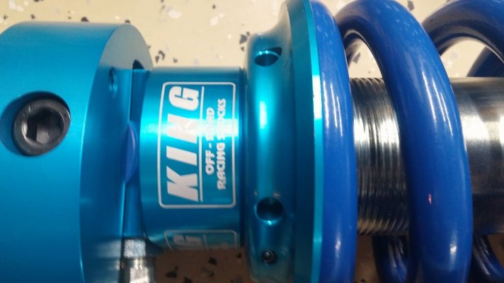

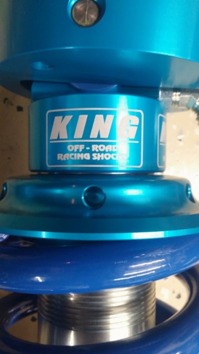

Tomt, do you have them set at 2.5”?, do you have the factory bumper ?
King told me they come preset at 2.5" but I got mine yesterday in the mail and they look to be set at 0 preload with the adjuster all the way to the top, can’t believe that will be 2.5”, they also told me 5 full turns with the adjuster will be 1", so i have a general idea on how to adjust the height.
Would you do me a favor and take a picture of your coilovers above the adjuster showing the open threads you have ? i see in your OP pictures your are actually showing open threads as they should have some, or count the open threads you have and let me know? i'd highly appreciate it.
I'll see if my bench vice is big enough to hold this fackers down to adjust them, otherwise this will be the perfect excuse to get me a new one :)
This is how mine looks like at the moment, i'm pretty sure this will be 0" lift

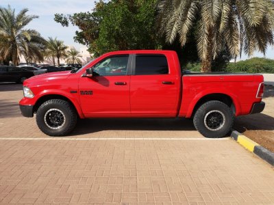

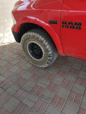

Hi guys, here is the big red with King 2.5 shocks. The front is lifted 14 threads and I think it looks like 4 inch lift, but leveled. The ride is a bit hard on road.and I will go offroad soon.
I have OEM rear springs with 1" spacer which I will replace soon with icon springs and re adjust the front shocks accordingly.
