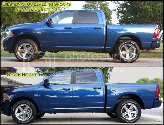

No idea how much they will settle as I have no experience with them but I did find this picture of one with it at 2.8

Thanks cloud for the pictures and thanks Bower for the explanation. Truck is 3 years old so i'll go for the 2.1 setting.
